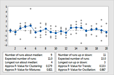

For example, a plastic manufacturer wants to assess its production process for one of its new products. They sample 5 products every hour for 20 hours and test the strength of the plastic. The following run chart resulted.
The gray points represent the individual values. The blue points connected with a line represent the means of subgroups. With the exception of one observation, the points appear to vary randomly around the center line (median). The approximate P-values for clustering , mixtures, trends, and oscillation are all greater than the a level of 0.05. Therefore, there is no indication of special causes variation or non-randomness.
