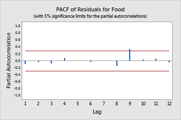

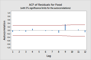

5    Click Graphs. Check ACF of residuals and PACF of residuals.
6    Click OK in each dialog box.

Graph window output
Interpreting the results
The ARIMA model converged after nine iterations. The AR(1) parameter had a t-value of 7.42. As a rule of thumb, you can consider values over two as indicating that the associated parameter can be judged as significantly different from zero. The MSE (1.1095) can be used to compare fits of different ARIMA models.
The Ljung-Box statistics give nonsignificant p-values, indicating that the residuals appeared to uncorrelated. The ACF and PACF of the residuals corroborate this. You assume that the spikes in the ACF and PACF at lag 9 are the result of random events. The AR(1) model appears to fit well so you use it to forecast employment in the Example of Forecasting with ARIMA.
