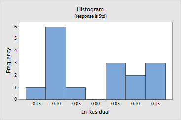

A histogram of the log residuals shows the distribution of the residuals for all observations. Use the histogram as an exploratory tool to learn about the following characteristics of the data:
·    Typical values, spread or variation, and shape
·    Unusual values in the data
The histogram of the residuals should be bell-shaped. Use this plot to look for the following:

Example Output
Interpretation
For the insulation data no evidence of skewness or outliers exists.
