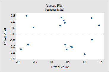

This graph plots the log residuals versus the fitted values. The residuals should be scattered randomly about zero. Use this plot to look for the following:
This pattern...
Indicates...
Fanning or uneven spreading of residuals across fitted values
Nonconstant variance
Curvilinear
A missing higher-order term
A point far away from zero
An outlier
Example Output
Interpretation
Based on this plot, the residuals appear to be randomly scattered about zero. No evidence of nonconstant variance, missing terms, or outliers exists.
