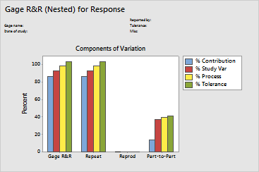

Graphs - Components of Variation
This chart is a graphical representation of the Gage R&R section of the Session Window output.
The sources of variation that are represented in the graph are:
·    Total Gage R&R, which is the variation due to the measuring system, including multiple operators using the same gage.
·    Repeatability, which is the variability in measurements obtained when parts from the same batch are measured by the same operator.
·    Reproducibility, which is the variability in measurements obtained when parts are measured by different operators.
·    Part-to-Part, which is the variability in measurements across different parts.
Separate bars represent:
·    %Contribution, which is 100 times the variance component for that source divided by the total variance.
·    %Study Variation, which is 100 times the study variation for that source divided by the total study variation.
·    %Tolerance (if a process tolerance is given in the Options subdialog), which is 100 times the study variation for that source divided by the process tolerance.
·    %Process (if a historical standard deviation is given in the Options subdialog), which is 100 times the study variation for that source divided by the process variation.
In a good measurement system, the largest component of variation is Part-to-Part variation. If instead you have large amounts of variation attributed to Gage R&R (Repeatability and/or Reproducibility), corrective action is needed.
Example Output
Interpretation
For the temperature data, you can see that most of the variability can be accounted for by the inaccuracy of the gage (Repeatability).
