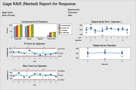

Gage R&R Study (Nested)
ANOVA Method
Graphs - Five-in-One
The five-in-one graph displays five gage R&R graphs in one graph window. The graphs include:
·    Components of variation - displays the sources of variation
·    R chart - indicates if operators are measuring consistently
·    Xbar chart - indicates if the measurement system is adequate
·    By Part - shows all of the measurements taken in the study, arranged by part
·    By Operator - shows all of the measurements taken in the study, arranged by operator
Example Output
Interpretation
To view the interpretation of each graph in the five-in-one plot, refer to the individual topic for each graph preceding this topic.
