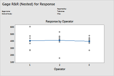

Graphs - By Operator
The By Operator graph shows all of the measurements taken in the study, arranged by operator. The measurements are represented by dots; the means by the circle-cross symbol. The line connects the average measurements for each operator.
Ideally,
·    the measurements for each operator will vary an equal amount
·    the part averages will vary as little as possible
Note
If the number of observations per level is greater than 9, a boxplot is displayed.
Example Output
Interpretation
The temperature data meets both of the ideal criteria above. There will always be some variation, but it appears the operators are measuring consistently.
