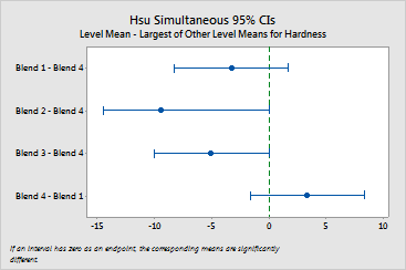

Example Output
Interpretation
For the paint hardness analysis, the largest mean was specified as the best. Therefore, the means for Blend 1 (14.733), Blend 2 (8.567), and Blend 3 (12.983) are all compared to the mean for Blend 4 (18.067) because this is the largest (best) mean. The mean for Blend 4 itself is compared to the mean of Blend 1, because this is the largest of the remaining three means.
The results indicate the following:
·    The confidence intervals for the difference between the mean of Blend 4, and the means of Blend 2 (-14.5000 to 0) and Blend 3 (-10.0833 to 0) both have zero as an end point, which indicates that these differences are significant.
·    The remaining 2 intervals do not have zero as an end point, which indicates that the differences are not significant.
