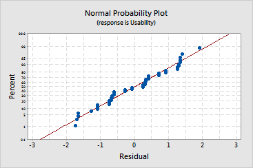

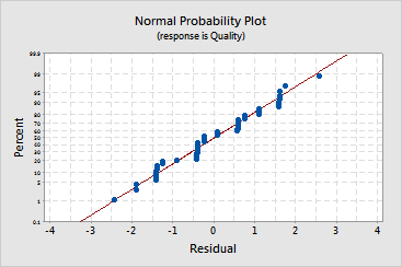

Example Output
Interpretation
For the door lock data, the residuals for usability and quality do not appear to follow a straight line. Evidence exists that the data may not be normally distributed.
