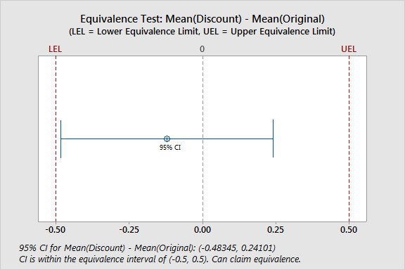

The equivalence plot summarizes the results of the test. If the CI (confidence interval) for the difference between the means is within your equivalence limits, then you can claim that the means are equivalent.

For the cat food analysis, the CI for the difference is completely within the equivalence interval. Thus you can conclude that both cat foods contain equivalent amounts of protein.
