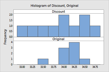

Graphs - Histogram
Use the histograms to compare the sample distributions. You can also use the histograms to look for unusual observations. You should investigate any extreme values.
Example Output
Interpretation
For the cat food data, the protein content for the discount food appears to vary more than that of the original formula. The distribution is wider and flatter. The means of the distributions appear to be similar and there do not appear to be any outliers.
