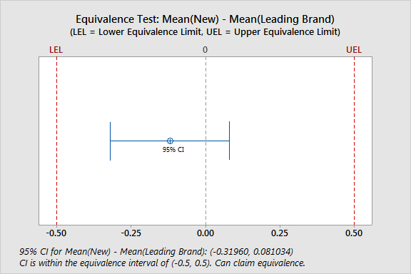

The equivalence plot summarizes the results of the test. If the CI (confidence interval) for the difference between the means is within your equivalence limits, then you can claim that the means are equivalent.
Example Output
Interpretation
For the contact lens data, the difference is clearly within the equivalence interval. Thus you can conclude that both cleaning solutions are equally effective at cleaning contact lenses.
