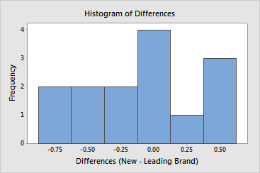

Graphs - Histogram
Use the histogram to view the distribution of the differences. You should investigate any extreme values or differences that appear to deviate significantly from normality.
Example Output
Interpretation
The histogram of the differences seems to indicate that they are approximately normally distributed and there are no outliers.
