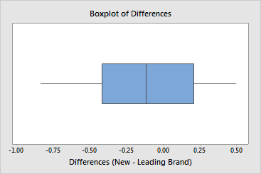

Graphs - Boxplot
The boxplot conveys the following information about the distribution of the differences:
·    The box represents the middle 50% of the differences.
·    The line through the box represents the median difference.
·    The lines extending from the box represent the upper and lower 25% of the differences (excluding outliers).
·    Outliers are represented by asterisks (*).
Example Output
Interpretation
The boxplot of the difference indicates that there are no outliers. The distribution appears to be symmetrical, with little or no skew.
