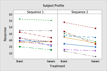

Graphs - Subject Profile Plot
The subject profile plot shows the responses for each participant, in each sequence, during each period of the study.
Example Output
Interpretation
The subject profile plot shows that the measurements vary between participants. However, for almost all participants, stomach pH was higher after the brand-name antacid than after the generic antacid. The pattern of responses appears to be the same for each sequence.
