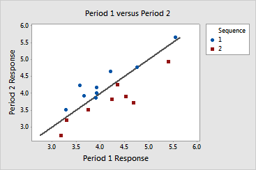

Example Output
Interpretation
The period plot for the antacid data clearly shows a treatment effect. The following patterns indicate that, for both sequences, the brand-name antacid was more effective than the generic antacid at raising stomach pH:
·    For Sequence 1, almost all of the points are above the line. This indicates that stomach pH was higher during Period 2 than during Period 1. Period 2 is when the brand-name antacid was given for Sequence 1.
·    For Sequence 2, all of the points are below the line. This indicates that stomach pH was higher during Period 1 than during Period 2. Period 1 is when the brand-name antacid was given for Sequence 2.
