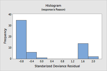

Residual Plots - Histogram of the Residuals
A histogram of the residuals shows the distribution of the residuals for all observations. Use the histogram as an exploratory tool to learn about the following characteristics of the data:
·    Typical values, spread or variation, and shape
·    Unusual values in the data
The histogram of the residuals should be bell-shaped. Use this plot to look for the following:
This pattern...
Indicates...
Long tails
Skewness
A bar far away from the other bars
An outlier
Because the appearance of the histogram can change depending on the number of intervals used to group the data, use the normal probability plot and goodness-of-fit tests to assess whether the residuals are normal.
Example Output
Interpretation
For the health care center data, the residuals have two groups. This pattern often means not enough data is in the set for normal approximation theory to apply. Confidence intervals for predictions are probably inaccurate.
The bin from 1.875 to 2.125 contains observation 58. Observation 58 is the point with the large standardized residual that is in the table that shows the fits and diagnostics for unusual observations.
