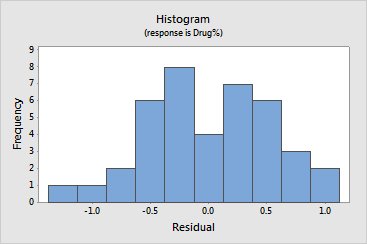

Example Output
Interpretation
For the pill data, the residuals appear to be reasonably normal.
