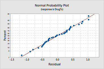

Residual Plots - Normal Probability Plot of the Residuals
This graph plots the residuals versus their expected values when the distribution is normal. The residuals from the analysis should be normally distributed. In practice, for data that have a large number of observations, moderate departures from normality do not seriously affect the results.
The normal probability plot of the residuals should roughly follow a straight line. Use this plot to look for the following patterns:

Example Output
Interpretation
For the pill data, the residuals appear to follow a straight line. This indicates that the residuals follow a normal distribution.
