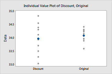

Graphs - Individual Value Plot
Individual value plots illustrate the following properties of your data:
·    Dispersion. Each dot represents a value observed in a sample.
·    Means. The blue symbols on each plot represents the mean of the sample.
Example Output
Interpretation
For the cat food data, the variation in the discount formulation is greater than that of the original formulation. The means appear to be similar and there do not appear to be any outliers.
