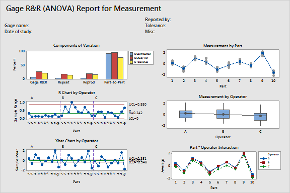

ANOVA method with GAGEAIAG data

Graph Window Output - GAGEAIAG.MTW
·    In the Components of Variation graph (located in the upper left corner), the percent contribution from Part-To-Part is larger than that of Total Gage R&R, telling you that much of the variation is due to differences between parts.
·    In the By Part graph (located in upper right corner), there are large differences between parts, as shown by the non-level line.
·    In the R Chart by Operator (located in middle of the left corner), Operator B measures parts inconsistently.
·    In the By Operator graph (located in the middle of the right column), the differences between operators are small compared to the differences between parts, but are significant (p-value = 0.00). Operator C appears to measure slightly lower than the others.
·    In the Xbar Chart by Operator (located in lower left corner), most of the points in the X and R chart are outside the control limits, indicating variation is mainly due to differences between parts.
·    The Operator* Part Interaction graph is a visualization of the p-value for Oper*Part - 0.974 in this case - indicating no significant interaction between each Part and Operator.
