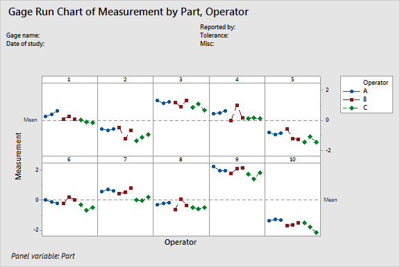

The GAGEAIAG data was taken from Measurement Systems Analysis Reference Manual, 3rd edition. (Chrysler, Ford, General Motors Supplier Quality Requirements Task Force). Ten parts were selected that represent the expected range of the process variation. Three operators measured the ten parts, three times per part, in a random order.

1    Open the worksheet GAGEAIAG.MTW.
2    Choose Stat > Quality Tools > Gage Study > Gage Run Chart.
3    In Part numbers, enter Part.
4    In Operators, enter Operator.
5    In Measurement data, enter Measurement. Click OK.

Gage Run Chart with GAGEAIAG data

Gage Run Chart Example - GAGEAIAG.MTW
For each part, you can compare both the variation between measurements made by each operator, and differences in measurements between operators.
You can also look at the measurements in relationship to the horizontal reference line. By default the reference line is the mean of all observations.
Most of the variation is due to differences between parts. Some smaller patterns also appear. For example, Operator B does not measure consistently and Operator C usually measures lower than the other operators.
