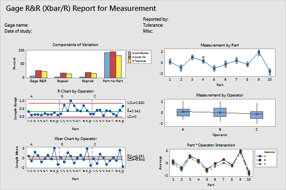

X and R method with GAGEAIAG data

Graph Window Output - GAGEAIAG.MTW
In the Components of Variation graph, a low percentage of variation (7.13%) is due to the measurement system (Gage R&R), and a high percentage (92.87%) is due to differences between parts.
Most of the points in the X Chart are outside the control limits when the variation is mainly due to part-to-part differences.
