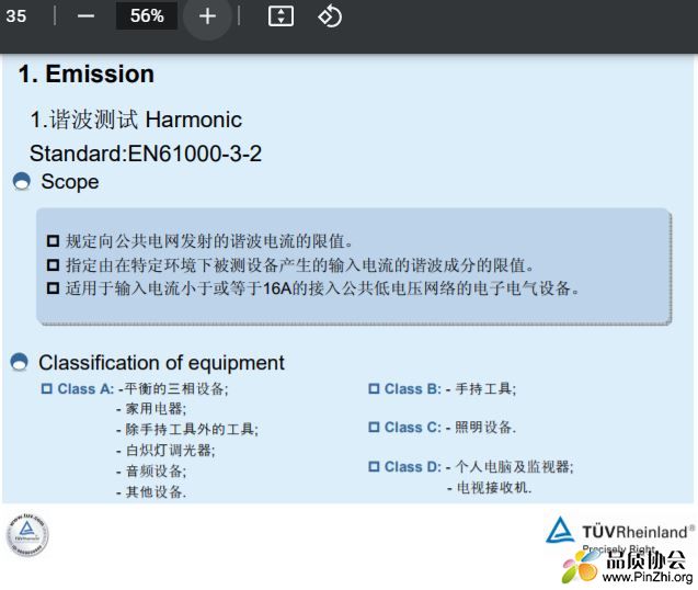

TUV的EMC测试项目详述培训
TUV的EMC测试项目详述培训
TUV的EMC测试项目详述培训
  • Harmonic EN 61000-3-2(≤16A)
  • Flicker EN 61000-3-3 (≤16A)
  • Radiated Emission (RE) EN 61000-6-4
  • Conducted Emission (CE)--- EN 61000-6-4
  • Electrostatic Discharge (ESD) IEC 61000-4-2
  • RF electromagnetic field (RS) IEC 61000-4-3
  • Fast transients (Burst/EFT) IEC 61000-4-4
  • Surge IEC 61000-4-5
  • lnjected currents (CS)- IEC 61000-4-6
  • Power frequency magnetic field - IEC 61000-4-8
  • Voltage Dip and lnterruptions - ----IEC 61000-4-11
EMC测试项目培训.pdf
1.04 MB, 下载次数: 69
EMC测试项目详述
