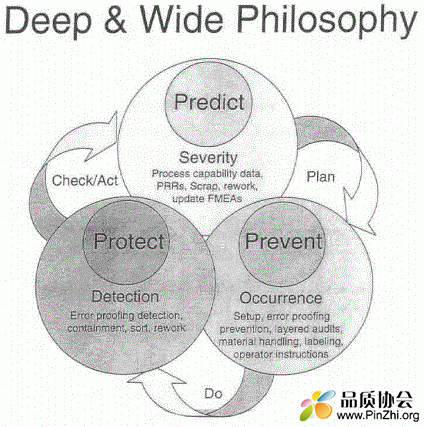

类似8D或5WHY的问题解决方法,Drill Deep & Wide (DDW) PhiloSOPhy
  • Problem Description : What was the problem as perceived by customerProblem Definition : What was the deviation to design record requirements
  • Containment : How was the problem contained at the plant/s
  • Root Cause Analysis : How to Predict, Prevent and Protect
  • Irreversible/Permanent Corrective Action/s : What are the corretive actions
  • Systemic Issues : What are the systemic issues which stem from the corrective actions
  • Systemic Issue Correction : Actions taken to address the systemic issues
Drill Deep & Wide
Drill Deep & Wide
