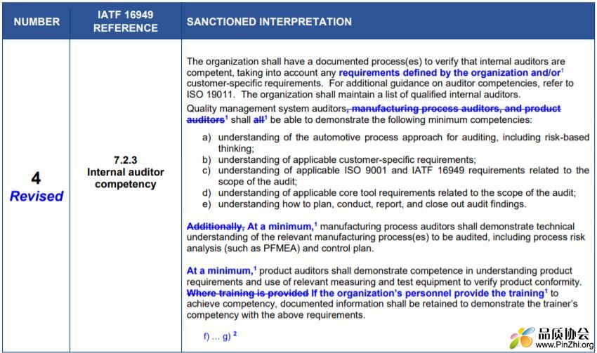

IATF 16949:2016 – Sanctioned Interpretations,SI 19 issued in August 2020, effective October 2020。
这次更新主要影响在条款 7.2.3 Internal auditor competency,如下
重点强调内部审核员能力的要求。区分质量管理体系审核员、制造过程审核员和产品审核员的能力要求。
IATF-16949-SIs-Aug-2020.pdf https://www.iatfglobaloversight. ... 49-SIs-Aug-2020.pdf
