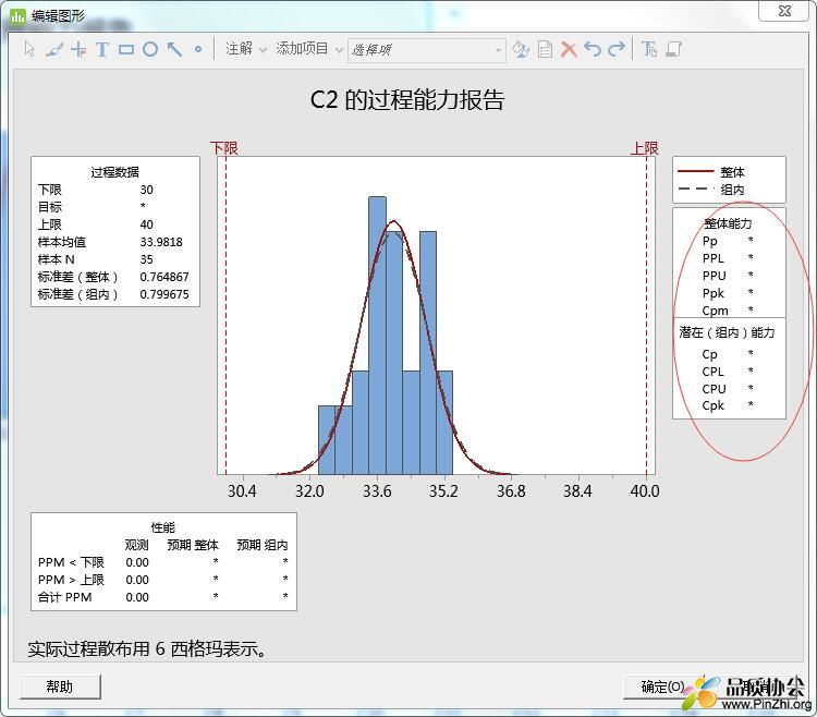

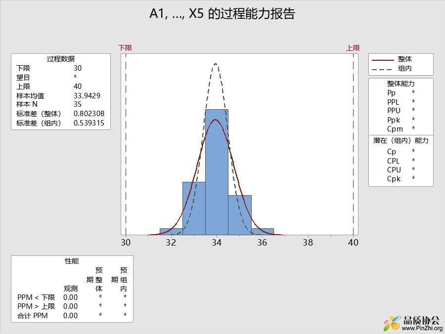

请假各位大佬为什么质量工具-能力分析-正态作图时,不显示CPK
不显示cpk数值
不显示cpk数值

发表于 2021-4-9 15:27:40 | 显示全部楼层
minitab给出的解释:
Lower spec: Enter the lower specification limit. Check Boundary to define the number as a "hard" limit. See Upper spec below for an explanation.
Upper spec: Enter the upper specification limit. Check Boundary to define the number as a "hard" limit, meaning that it is impossible for a measurement to fall outside the limit.
Note
You must enter a lower specification limit and/or an upper specification limit.
When you define upper and lower specification limits as boundaries, Minitab sets the expected percentage of values that are out of specifications to * for a boundary.

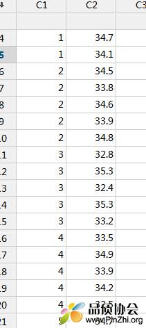

发表于 2021-4-9 13:37:23 | 显示全部楼层
没看出来哪儿有问题?你把数据贴出来我来试试

发表于 2021-4-9 13:43:37 | 显示全部楼层
我把你的数据逆向处理:calc-random data-normal, 产生数据,然后再算CPK 可以有数据CPK=1.53.
如果你的不显示CPK , 有种可能是你的数据不是正太分布。(可以试试stat-basic statis-normality test 看看P值)

发表于 2021-4-9 15:23:23 | 显示全部楼层
我又试了一下自己产生的数据,边界的框如果勾选后,就没有CPK 数据

 楼主| 发表于 2021-4-9 15:55:18 | 显示全部楼层
明白了!!感谢!
