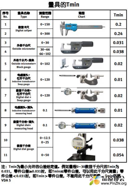

量具精度选择的标准, 大家可以参考. 数显卡尺 Digital calipe, 外径千分尺 Outside micrometer,外径千分尺+量块 Outside micrometer+Block gauge,电感测头+杠杆千分尺 inductive transducers+Snap gauge,数显千分表+杠杆千分尺 Digital dial + Snap gauge,电感测头+测头 inductive transducers+measuring head,数显千分表+测头Digital dial+measuring head, 数显千分表 Digital dial gauge.
量具选择.pdf
107.65 KB, 下载次数: 185
量具精度选择
