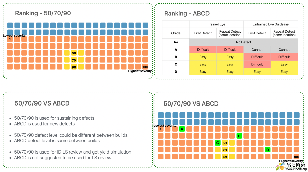

ABCD ranking: It’s a relatively objective method for severity assessment in accordance with the divided visual feeling from trained eyes and untrained eyes. A/B/C/D defective level is same between builds.
