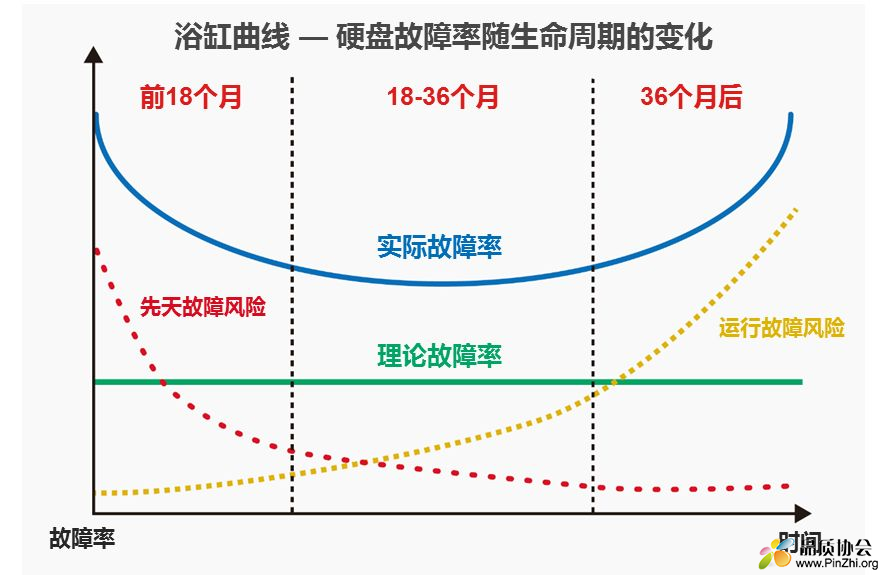

浴盆曲线(Bathtub Curve)
浴盆曲线(Bathtub Curve)
