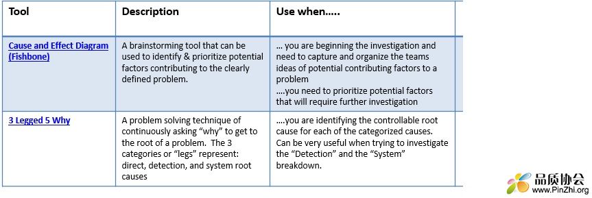

各位同行,发生质量异常,可以使用5why或者鱼骨图分析原因。但是5why与鱼骨图分析出的结果不一样,怎么办? 例如:5why分析出的是A原因,但是鱼骨图分析出的是B原因,甚至,有的时候,原因A与原因B是相互冲突的(或相互矛盾的)。
有这样的问题说明你对常用的质量工具掌握不够,不明白每种工具的不同用法,建议加强学习。
fish-bone:
Brainstorm possible causes for analysis
Rank potential causes and determine high-potential for further study
Gather data to support or refute each idea circled
5 why
A fundamental principle of root cause analysis activity is that you must relentlessly continue to question conditions until you uncover those that are the primary contributors of the problem.  Five-why diagrams are a visual representation of that thinking.
Using one of the primary potential causes identified in the earlier cause and effect diagram, the team uses a questioning strategy to drive deeper toward potential root causes.
The questioning strategy can, and often needs to, go beyond five levels.  It may also split into multiple answers that creates multiple questioning trees.  It is also possible that a stopping point will occur before five whys are reached.  Any of these scenarios is acceptable as long as the result is a controllable potential cause that the team can investigate and correct.
