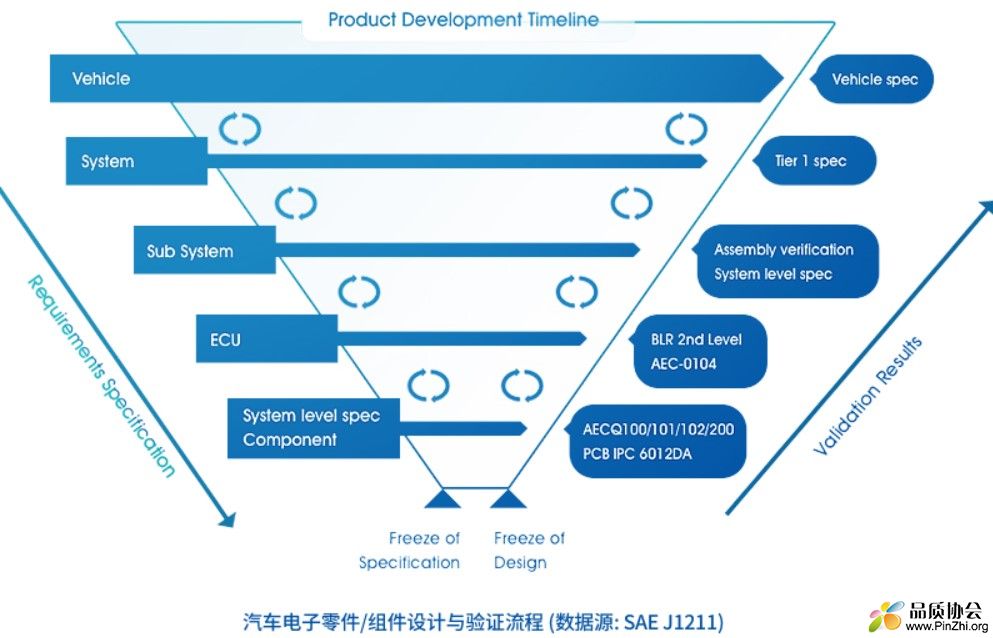

汽车电子零件和组件设计与验证流程
汽车电子零件和组件设计与验证流程
汽车电子可靠性需求和验证标准
车用主动与被动器件可靠性标准
-AEC-Q100 Integrated Circuits
-AEC-Q101 Discrete Semiconductors
-AEC-Q102 Discrete Optoelectronic Semiconductors
-AEC-Q103 MEMS-Sensor and Microphone
-AEC-Q104 Multichip Modules (MCM)
-AEC-Q200 Passive Components
-SAE J1879 Handbook for Robustness Validation of Semiconductor Devices in Automotive Applications
车用PCB/PCBA板级可靠性标准
-IPC-A-610G: Acceptability of Electronic Assemblies
-IPC-6012DA: Automotive Applications
-IPC-J-STD-001GA/A-610GA: Automotive Addendum to IPC J-STD-001G Requirements for Soldered Electrical and Electronic Assemblies
-IPC-9701A: Performance Test Methods and Qualification Requirements for Surface Mount Solder Attachments
-9702-WAM1: Monotonic Bend Characterization of Board-Level Interconnects
-IPC/JEDEC-9703: IPC/JEDEC Mechanical Shock Test Guidelines for Solder Joint Reliability
-IPC/JEDEC-9704A: Printed Circuit Assembly Strain Gage Test Guideline
车用模块可靠性标准
-Road vehicles — Environmental conditions and testing for electrical and electronic equipment — Part 1: General
-Road vehicles — Environmental conditions and testing for electrical and electronic equipment —Part 2: Electrical loads
-Road vehicles — Environmental conditions and testing for electrical and electronic equipment —Part 3: Mechanical loads
-Road vehicles — Environmental conditions and testing for electrical and electronic equipment Part 4: Climatic loads
-Road vehicles — Environmental conditions and testing for electrical and electronic equipment Part 5: Chemical loads
-SAE J1211 Recommended Environmental Practices for Electronic Equipment Design
-JASO D001 General Rule of Environmental Testing Methods for Automotive Electronics Equipment's
